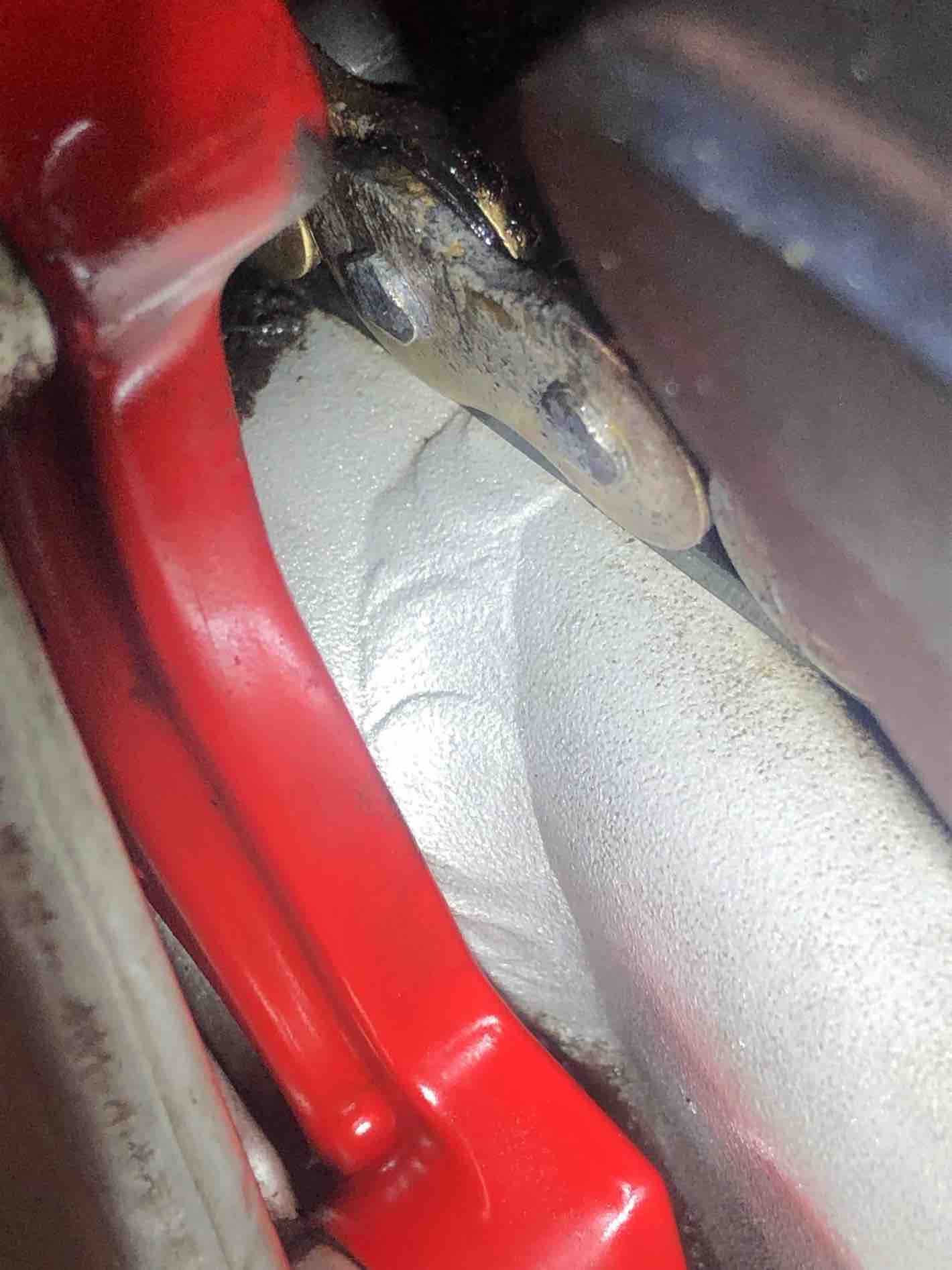

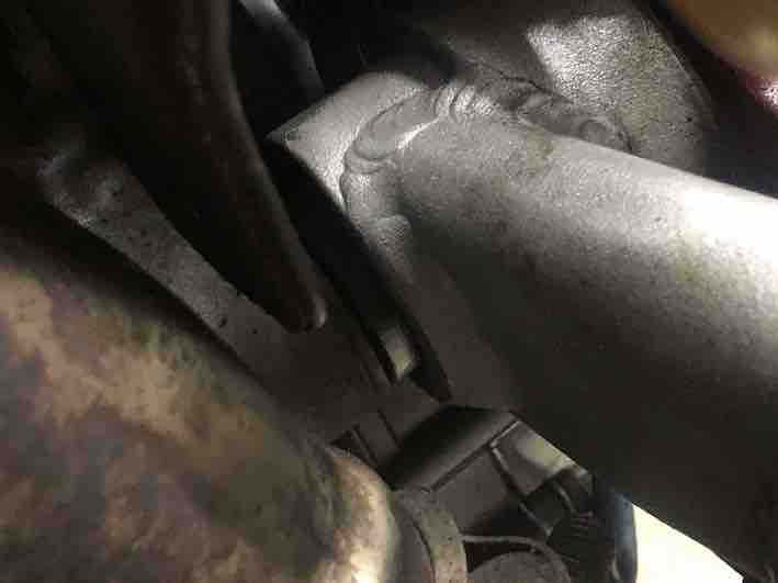

Soooo what I feared happening has happened!! Tonight at approx 19:00 after just overtaking 2 cars on the range road between Tidworth and Bulford Camp approx 80 mph ( I could be wrong as I wasn't looking at the speedo officer ) the swingarm snapped causing violent change of direction to the other side of the road and was unable to correct the direction of travel foooortunatly there was no oncoming traffic, the back wheel didn't lock up but thick blue rubber smoke filled the air , I didn't lose control and I managed to bring the bike to a halt. The back wheel is no longer behind the front wheel and is facing in a different direction . The righthand side of the swingarm is completely snapped and about 6" above where it should be so the bike has dropped in height and the side stand is now too long to be of any use. If anybody knows anyone who has a swingarm for sale please pass on my details or is aware of a interchangeable part from another bike

The break follows the weld exactly so it clearly is the welding process, I very much doubt the new owners of the company will tskd on any responsibility for the recall , I'm gutted as I've only had the bike since Feb n had nothing but problems I finally thought it sorted it

pics of my swinging arm, can we build up a gallery which might save someone a nasty crash..

my swinging arm
- morini.jpg (73.1 KiB) Viewed 14043 times
- morini1.jpg (105.04 KiB) Viewed 14043 times

I had the rc 2128 code which is now fixed due to sending the instrument cluster away I still get the " rc " come up now and again but no problems, ref over heating moto hub told me to keep the expansion tank empty as it will just overflow when it gets hot I've done this and not had any problems however I've had all the other problems associated with the gp that I expect that'll be my next one
on the swingarm welding if your welds look concave then those are the ones tgat are likely to fail as the arm was not quote flush when weldred and the weld fell into the gap causing a weak spot my welds were concave and I regularly checked for cracks so I either missed one or it just failed when I was out I'll post photos of my swing arm

thanks for posting pics , looks like a catastrophic break as opposed to gradual , which is scary.
who is repairing your swinging arm, and how are they going to do it reliably, being a thin wall casting.
I did think about seeing if it is possible to add bracing to the pivot points on the arm, let me know if you have any joy.
