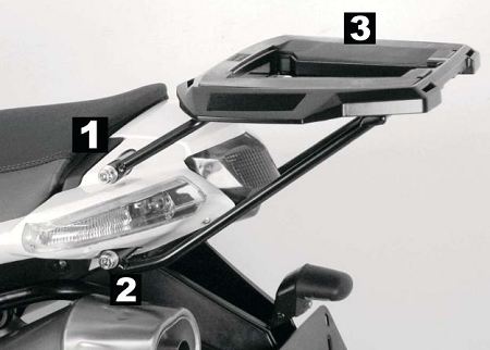

Not done any rim changes however, I have just bolted on a Hepco Becker rear rack and can thoroughly recommend that as a really worthwhile mod. Simple to fit and robust.
Also you do not need to have the "hoop" fitted all the time - it is only necessary when using the Silver H&B Rimowa or other H&B cases.
