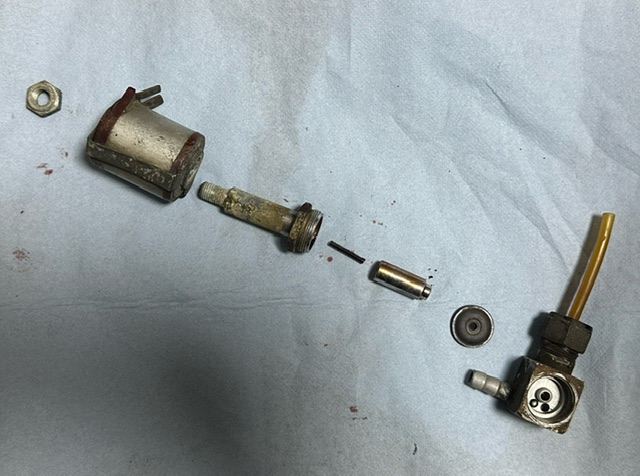

Does anyone have a breakdown of the electronic fuel tap internals.
I have checked the rubber membrane only to find I haven’t got one.

Here you go Paul.
This is a scabby one in need of a clean up (and a new club diaphragm!)
The diaphragm is not symmetrical- there is a domed face with a little recessed hole in the centre and a side that looks like a moat running around a raised island.
The raised island is the pad which seals against the fuel inlet, so faces the fuel. The dome and little recessed hole face the solenoid.

Thanks Tom, most helpful.
