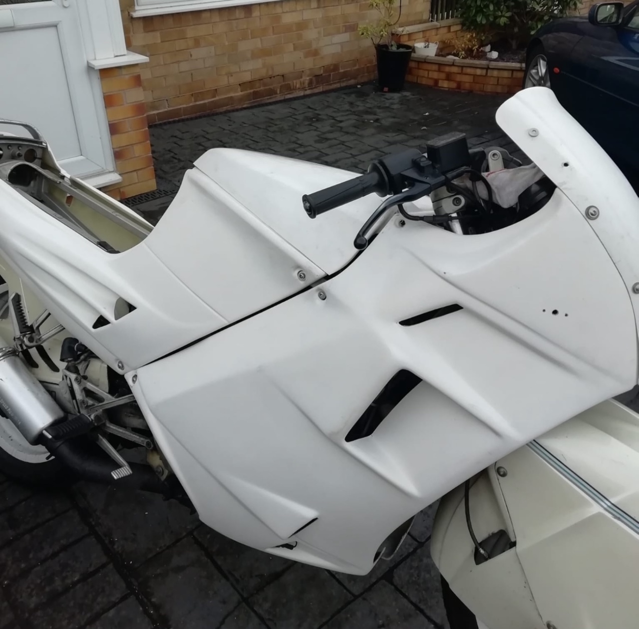

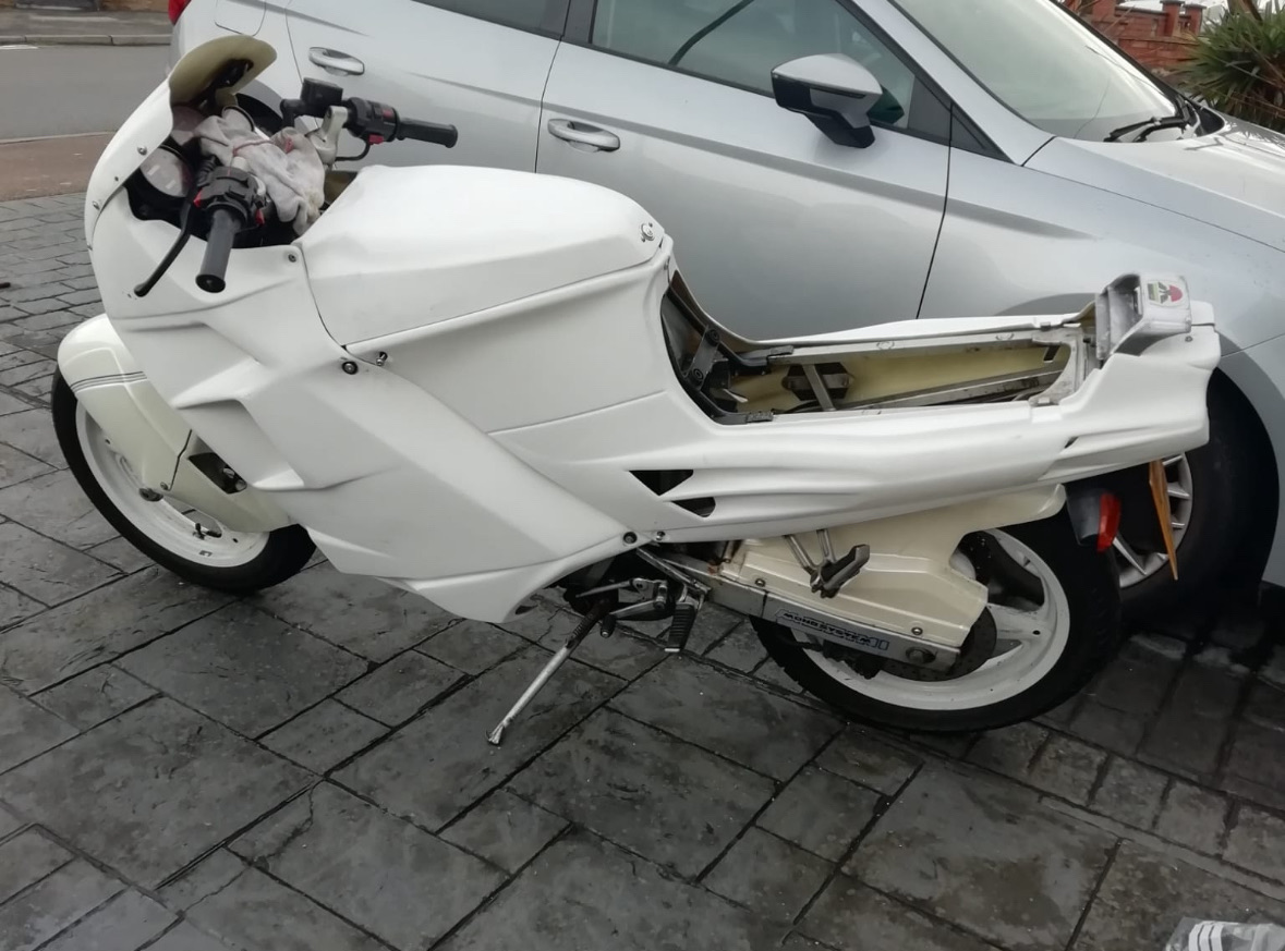

Regarding the bodywork:
Fibreglass to repair them is possible. Sadly the original plastic is brittle so cracks are happening more and more.
The UK club has just paid for tooling to make more panels in fibreglass. The final batch is in production now, if you want a set and you’re quick we might be able to add another set onto the order. They are £600 plus shipping (could collect from us at our rally in Kent in June). The panels as supplied are plain white fibreglass and will need prep and paint.

Here are some pics of the panels as they are delivered- no paint.
- IMG_8317.jpeg (225.46 KiB) Viewed 8330 times
- IMG_8318.jpeg (284.88 KiB) Viewed 8330 times
