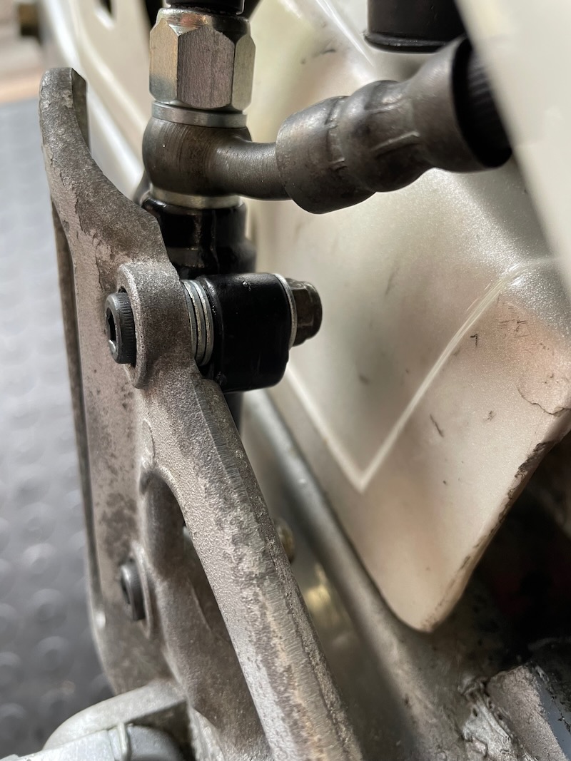

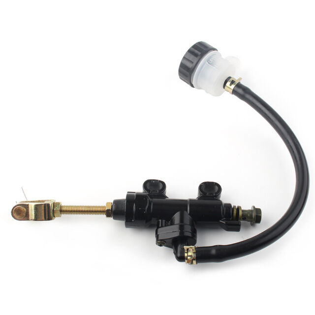

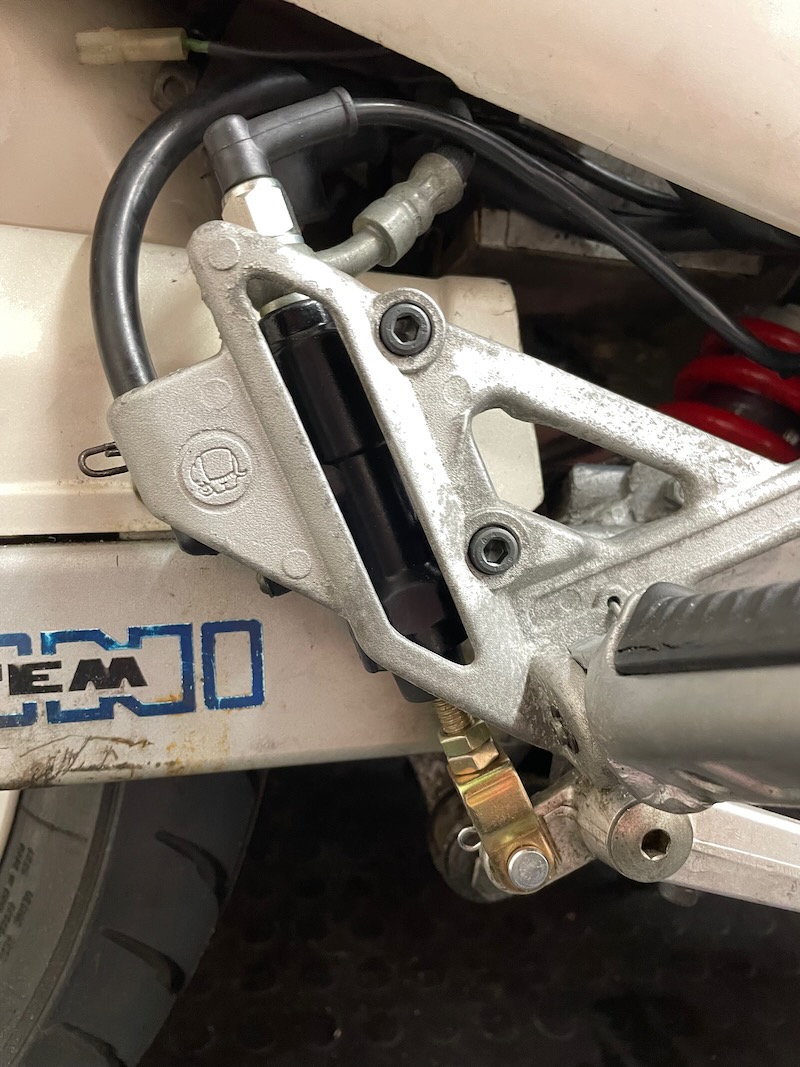

Just to close this one out: the Dart master cylinder is an extremely obscure part (shared only with some rare Bimotas, it appears). It's not available anywhere and nor are repair kits.The 70mm spacing for the fixing centres is also unusual.
However, I was able to find a cheap Chinese part on eBay that does the job.
https://www.ebay.co.uk/itm/384586537157
It needed a few packing washers to space it correctly off the mounting bracket (and slightly longer fixing bolts).
I also had to replace the Morini brake light switch with a 1.25mm thread pitch unit (the original Morini switch is 1mm pitch)
https://www.ebay.co.uk/itm/403199223455
Finally, it needed an M6 18mm clevis pin to replace the original Morini clip.
The original fluid reservoir was retained.
It works fine and looks OK (if not 100% original)
