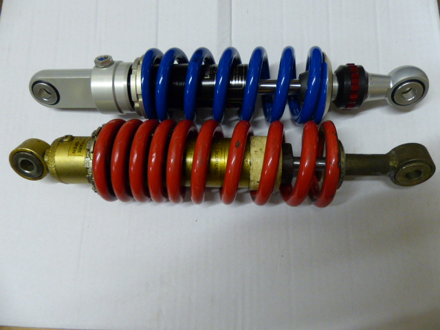

I'm glad to hear that the spring has made a good improvement to your dart. Interestingly, Wilbers came to almost the same solution for my spring rate as Daren spec'd for yours- I've got a 115N/mm linear spring. It's reassuring to know that two different methods of spec'ing the spring have come to almost the same answer. Hopefully when I get round to fitting and roadtesting it (after the winter I suspect) I'll be as happy as you.
For anyone else interested, I ended up getting a wilbers 630 (not the 631 I originally wanted because wilbers think the remote compression damping reservoir has a clearance issue in the cagiva freccia- I reckon I could have made it fit but didn't want to take the risk as it would be a very expensive mistake!)
The 630 has 22 click adjustable rebound damping (631 gets high and low speed compression damping too) and weighs 1.8 kilos including spring (dart original shock is 2.8kg) Importantly for me the spring diameter is 4mm less than the OEM spring which will give me some extra clearance on my exhaust. Total cost delivered to the UK was just a shade over £300.
Below is a photo of the dart original and wilbers side by side.
Tom

So, the Wilbers is now fitted.
Out with the old. Front paddock stand and a ratchet strap looped round the rear and suspended from a stepladder work well for me:
Not much room for the damper because of my exhaust. The OEM spring runs incredibly close to the pipes, luckily the wilbers is a few mm narrower. Not ideal for keeping the shock cool but no room for pipe lagging. One day I may replace that section of pipe with an oval section for a bit more room but so far I've not noticed any significant change in damping after a long ride:
In with the new:
I'll have to wait until after the winter before I get to road test now, but in the garage at least it feels miles better with supple damping and no soggy initial travel.
