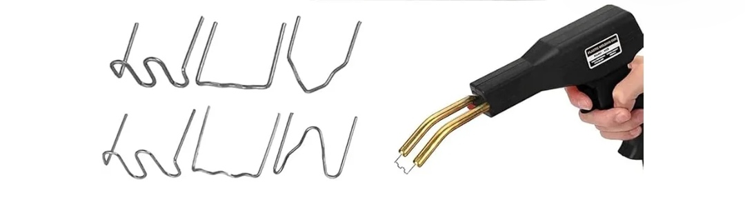

the fairing on my dart is damaged in exactly the same places , and and not easy to repair , as the plastic has become amazingly brittle.
i bought one of those aliexpress plasic repair kits , where you can melt stainless wire into the plastic.
that makes repairs a bit easier.

thank you, I also bought this plastic repair kit :lol: . I will reinforce the inside of the fairings also with fibreglass, if you roughen the ABS plastic well, then the resin will also stick to it. I will report back and upload pictures here in the forum.

Hi guys i repaired some Deep cracks on my dart fairing with some metal reinforcement, cianoacrylate glue, special Power and primer, here in Italy we can found a complete kit for this job, usually Is cheap around 40 euros, It Is important tò clean perfectly the surfaces, then reinforce the fairing with hot metal and then clean again and glue the parts i can shop pictures in the next days
