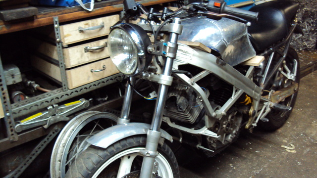

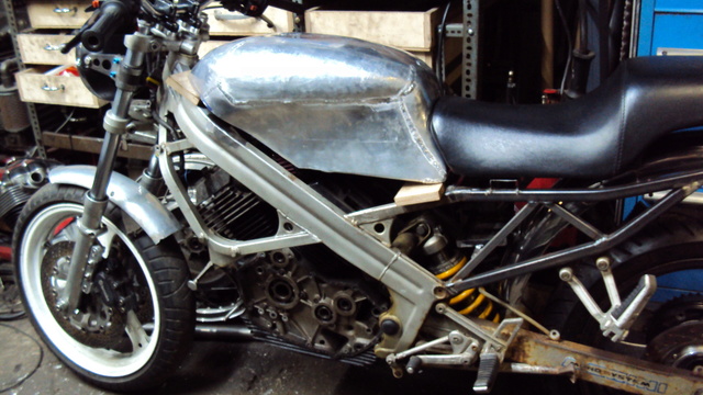

Some mounth ago as I didn't have the fairings I started to transform the look of my Dart 400 . But unfortunately I fell ill and I did not finish it yet .
Than here is some photos of my work that I hope to finished this year . I also changed the front fork by a Ceriani GP , the rear frame and the wheels are front rims from Suzuki just to have to similar wheels in 17" . Now the petrol tank is at a bodybuilder friend's house to finished and paint it .
The start with a piece of wood
Than the tank in aloy

Nice work!
I’ve always quite liked the look of the dart in its naked form.
What’s the rear shock you’ve got fitted? Loss of damping in the original marzocchi is always a problem on darts. I had Wilber’s make a custom shock for mine but an off the shelf option may be helpful for others
