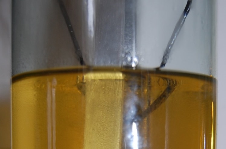

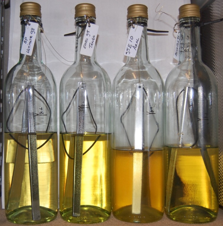

another update after a year and 3 months on the shelf... evaporation (compared to starting weight):
BP Ultimate 98: -11 g (-59 g)
Tango Euro 95: -12 g (-87 g)
Aral 95E10: -16 g (-126 g)
Haan BlueOne 95 : -13 g (-96 g)
DSC_3193 - kopie.JPG (181.17 KiB) Viewed 30527 times
The Aral E10 clearly has moisture in the mixture, when I took the bottle from the shelf thick drops sank to the bottom
The algea in the BlueOne keep on growing, a few dropped to the bottom while weighing the bottle. There is still moisture around the fuel level but no moisture problems like in the Aral E10
But, no corrosion or solved o-rings or such...

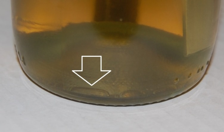

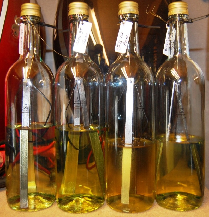

The mopeds are coming from the garage into a new season, lets see how your petrol looks if you have done only 50 miles last season (and your remaining petrol is about 18 months old...)
DSC_3325 - kopie.JPG (245.95 KiB) Viewed 30445 times
BP Ultimate 98: -3 g (-62 g)
Tango Euro 95: -6 g (-93 g)
Aral 95E10: -5 g (-131 g)
Haan BlueOne 95 : -6 g (-102 g)
In the Aral E10 is clearly a layer of water in the bottom of the flask, de algae in the BlueOne are still happy and growing steadily.
October the next update, drive safely, keep the rubber under and fill up responsibly!

just calculated the percentage of fuel avaporated:
BP Ultimate 98: -3 g (-62 g) ≈ 16%
Tango Euro 95: -6 g (-93 g) ≈ 24%
Aral 95E10: -5 g (-131 g) ≈ 36%
Haan BlueOne 95 : -6 g (-102 g) ≈ 31%
