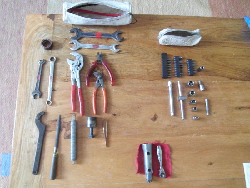

Since I returned to that beautiful bikes in 2000 I began reducing the tools and spare parts to carry with me (also thinking that the spares you carry you won´t need!). As you may know I built up Dulcinea by my own so I do know exactly what I need (there is no phillips screw and the only slotted screw is the one for the mixture on the carbs).

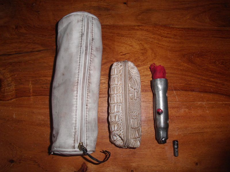

The discovering of a very tiny but strong ratchet of high quality from Wera Mini Zyklop/Förch (Wera 8001 A , 60 dents snaping at 6°) was a great step forward. All kind of bits enter directly, together with a ¼ inch adapter and an extansion you only have to carry the bits and hexagonal nuts you need. And if you solder a ¼ inch nut that you´ll lnever need (for ex. 7mm) in an old school plug spanner you can even take out the rear plug of a 501 Camel using the ¼ inch adaptor withut dismanteling half the bike!
And you won´t need to carry a 14 mm spanner that we only need to take of the cube of the carbs and not even a 17 and 19 or 28 or 30 mm spanner to take of the wheels or adjust the chain if you have a nice Knippex pliers on bord that opens parallel and will not hurt the nuts. (the big spanners of the foto usually I don’t carry with me)
With the tools in this two bags that don´t ocupy that much place I can take off the cilinders and do the normal maintenance works. Ok, to take off the alternator I have to look for a 22mm spanner and loosen the nut by stepping on the rear brake with 6. gear engaged, but I have the extractor for the flywheel on bord.

Hello Norbert
That's very interesting your optimising of the toolkit.
I think after many years of travelling you have reached the epitome of the travelling tool kit.
Is that an ex CZ or Jawa spanner on the left?
I have a Suzuki 14/17 spanner and a Kawasaki plug tool.
Since I travel in the company of a 250 2C we also carry the 22mm for the wheel nuts.
I ground the end of some needle nose pliers to double as circlip pliers.
I will add some fuses, zip ties, wire, a length of fuel pipe oh and disposable gloves.

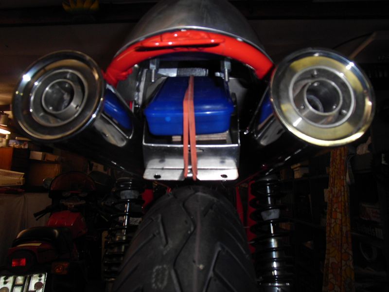

After I having had problems with a red pickup in Italy 1980 England 1982 on longer trips i always carry a pickup an a transducer (never needed them myself but at some morini meetings other peolpe could get home :wink: ) These have their place together with a chain lock in a tupper box in a folding compartment underneath my aluminium hump.

As I have a very sofisticated electronic in the head lamp i take withe me a spare platine (in case of a destroyed lamp) that is in the wooden box
That looks like a lot but ocupies less space than the rain preservative. I don´t take that stuff with me on any trip. But I use to make longer turns of about 3-500km and then i feel much better having with me some of the essential spares that you won´t find on the way.

I still take it on VMCC section runs and though they are rarely longer than 100 or so miles I take a few tools. No toolbox on the 2C/375 (removed to facilitate 350 engine and space to mount NLM ignition module and coils), so usually carried in a jiffy bag in a magnetic tank bag.
A useful two ended ring spanner with one end for the rear wheel spindle nuts and the other for the front. I can't remember where it originated. Not a Morini issue one I think - possibly even from a 1975 R90/6 toolkit. A Halfords 1/4 drive socket set in its small plastic box covers most small hex nuts and screw types. A weird plug spanner with a hex head that you can actually get the rear plug out with using an open ended spanner on the hex (350 is a tight fit in a 250 frame). A small 'adjustable' spanner and small thin nosed mole grips. Articulated C 'hook' spanner for exhaust nuts. The kit also works for the 57 Gilera 175 with just a substitution of spare plug type. That has side tool boxes, but the knurled fastener on one let go on the Levis Cup trial a couple of years ago, so I tend not to trust them. Luckily, another locally based competitor spotted the jiffy bag (luckily with address label) of spanners it contained at the side of a lane and reunited me with them a few days later.

Posts: 937
Re: tools for traveling
As said, I´m delighted withe the old style one in combination with this little ratchet (on the first foto the ratchet is inside the spanner). I guess less volume is nearly imposible and it works even for the rear plugs of an enduro :wink:
