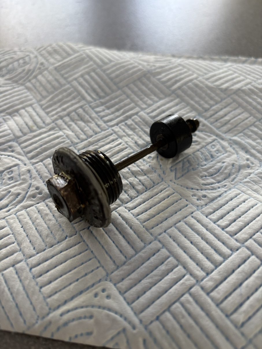

Hi, has anyone repaired one of these plugs successfully?
The one from New York’s wire is broken off flush so nothing outside to solder to.
As far as I can deduce the float has a magnetic core which suggests the presence of a reed relay in the wee tube. When the float moves down the reed relay flips and so lights the light. Tests show that it does work.
So is it as simple as unsoldering the top of the tube; extract the innards and solder a new wire on the bottom?
Any thoughts?
Steve

It is as you say, but it’s not easy to do. I would probably not try going in from the top, I’d probably try digging the epoxy out of the bottom and splicing on. Disturbing the brass tube and solder risks having oil leaks in the future too.

I will try the splicing route first. I did fix one many years ago on a Dart but that had a few mm of wire poking out.
Yes, I do like things to work if possible, and a bit of figglin’ can be rewarding.
Will go into battle tomorrow…….

I removed the epoxy and did manage to get a vey small bead of solder on the end of the stumpy wire and attach a bit of violet wire, the correct colour even. The float worked and switched correctly. I slid some heat shrink down to prevent the joint shorting to the brass plug and shrunk it up. Almost straight away the wire dropped off; there was not enough to make a robust mechanical joint.
Maybe I could reattach and fill with epoxy again which may mechanically support it
NOS is a possibility or even old, old stock but I have not seen a likely source yet. Even Mr Lucas drew a blank.

Repair is completed. Refixed withe solder and filled up the dish with araldite. Seems much stronger, I will give it a bit of support with a cable tie to the frame will see how it performs.
Thanks all for wise counsel.
