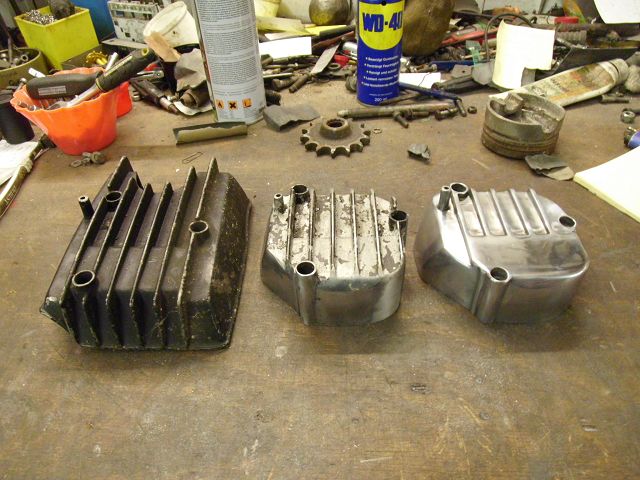

In terms of access to the tappets, the New York's tappet rocker box covers are relatively small and enable the tappets to be checked and adjusted easily, they're held in place with 35mm 6mm cap head bolts. The Kanguro X had the larger 3 1/2 style tappet rocker box covers and use 50mm 6mm cap head bolts. It took me perhaps 10 - 15 minutes to remove the rear cover! I've now fitted the rocker box covers from a Dart to the Kanguro X and it's made accessing the tappets so much easier and I can do so without disturbing the air box. The Dart has black painted versions of the same rocker box covers as the New York/Excalibur which are chromed.

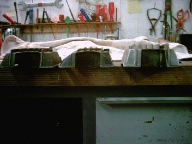

The rocker box covers of the 501 engines and obviously Darts as well are some mm lower. The early covers of the first 350 serie also is lower as the normal/current ones, maybe even 1mm lower than the 501 covers. These few mm can make a great diference when dealing with the rockers. I´ve got 501 motors in tremezzoframes from 74 and 81. As for me the funcionality is much more apreciated than the originality, I´ve cut the covers to reach easily at plugs and rocker covers. No problems with overheating at all. I´ve cut some lower 501 covers for the rear cilinder and normal ones for the front.
from the left: 1st serie, 501, normal 350/500

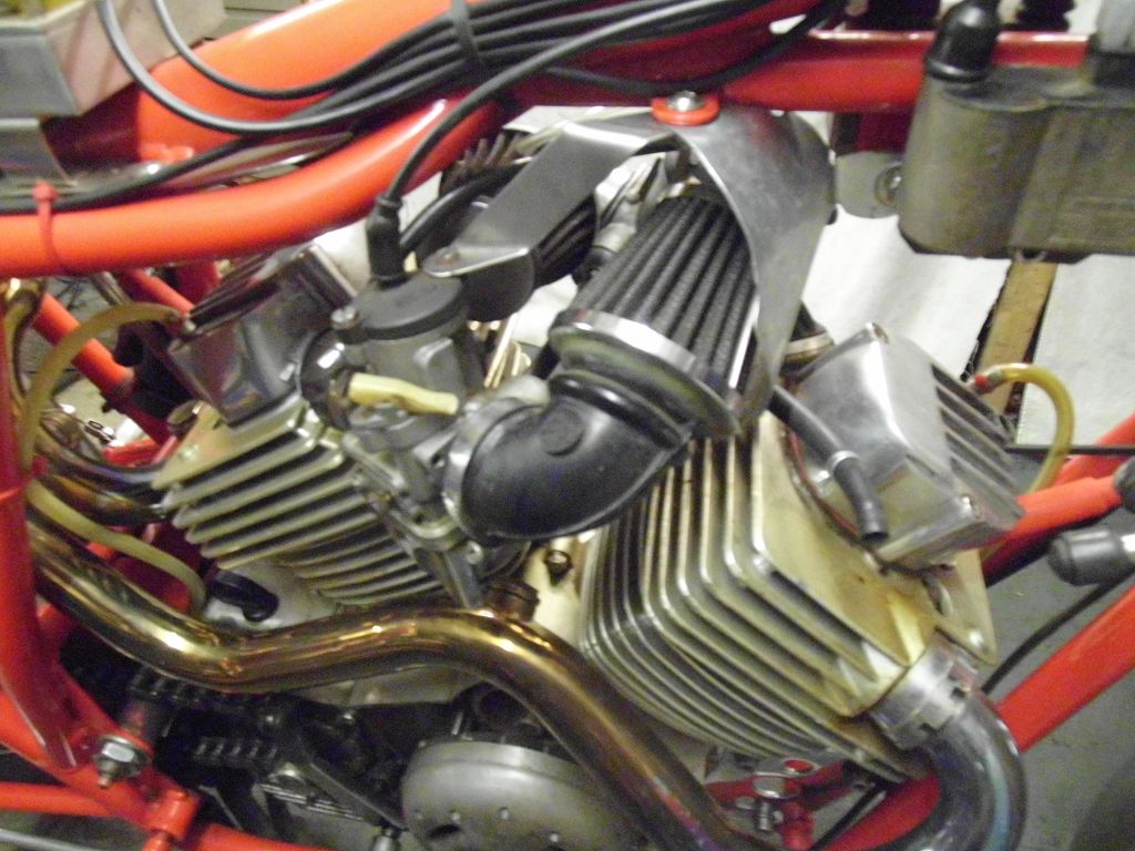

as you can see there ist a quite good acess to the rocker covers. These K+N replicas were a shit, quitting in the first rain. The aluminium winsdhield worked, but I replaced them later with Polini filters.
The carburation of the two bikes is absolutely diferent acording to needle position and mainjet, both with X18 needle but 268T difusers instead of 264BC (like original 501 setting). The difference of needle posicion (second and fourth notch) and mainjet (130 and 115) is dued to diferent exhaustsytems, cams and airfilters.
