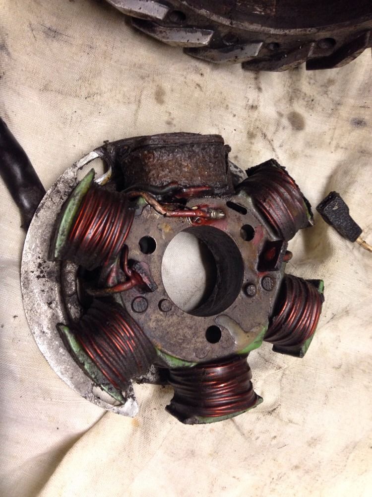

Hi Guys,
I'm looking at what I think is a late Excalibur stator*. There are four wires coming out of it.
Green - Ignition winding.
White - Earth.
Yellow - Generator winding, this wire has a "1" ferrule on it.
Yellow- Generator winding.
I can't understand why one of the yellow wires has a "1" ferrule on it. Anyone know?

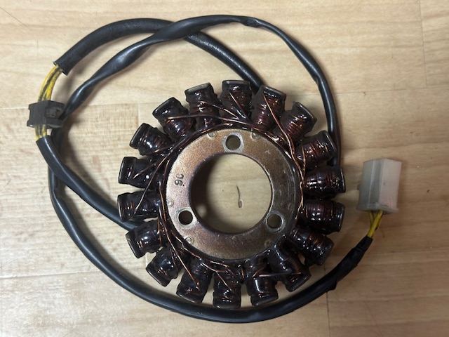

Won’t be a kokusan one with a green wire. The kokusan ignition doesn’t use a self generating ignition winding like the ducati electronica ones.
Kokusan stator has 3 yellow wires only and many very neatly wound coils

This is a kokusan one

morini_tom wrote: 05 Mar 2024 19:47 This is a kokusan one
Thanks Tom. You are right it has a Green wire and doesn't look like the Kokussan one in your photo. It has many less poles for a start :D

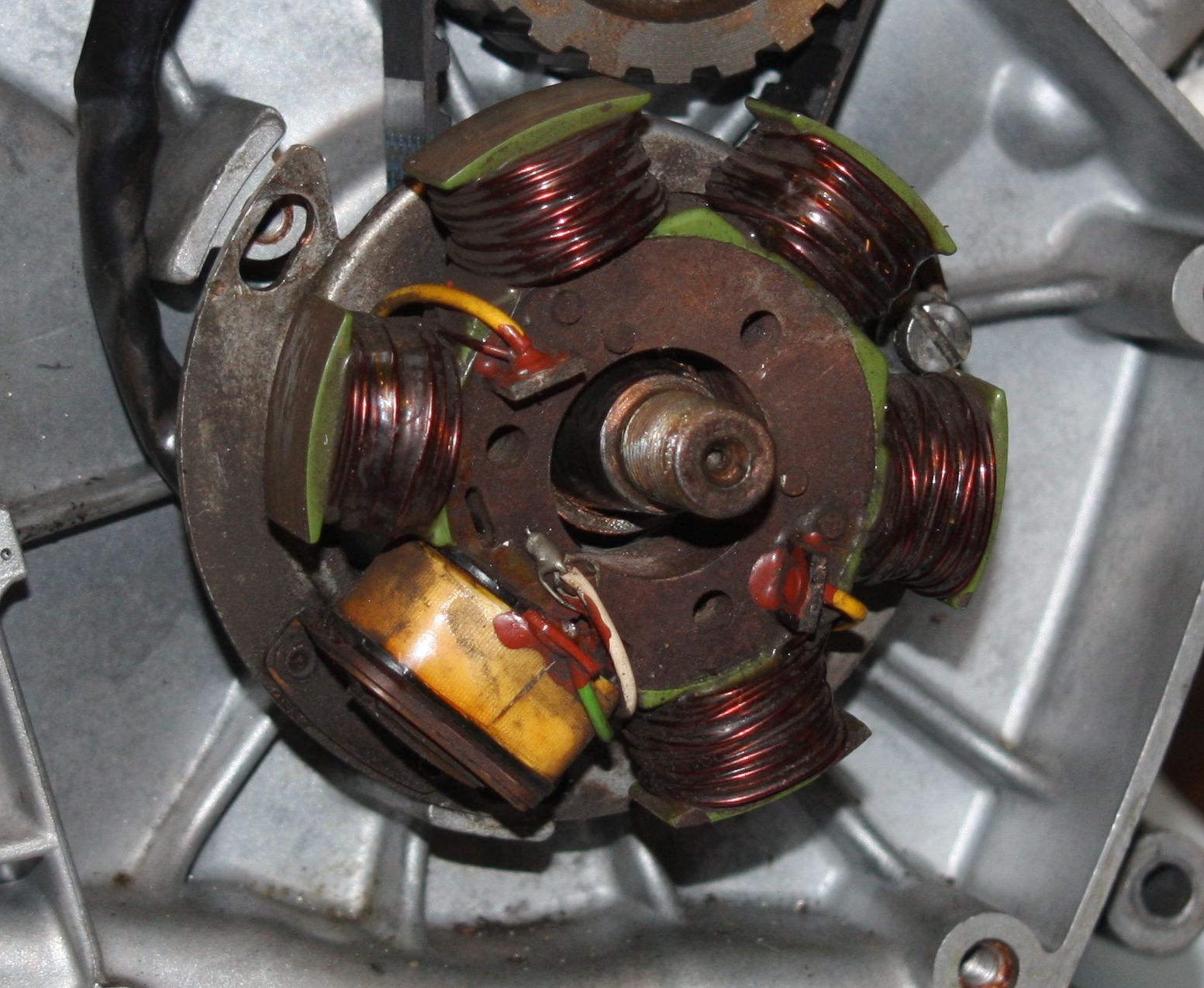

Re: Stator Question
So it will be a "bodyless" stator, with the wire wound directly on the steel-plate-paket. It´s the strongest one with about 200W
körperlose Lima.JPG (136.42 KiB) Viewed 11205 times
Cannot find a better foto. This one is quite uggly. Only the ignition coil has a plastic body (this one burnt)
So probably you also have one of the strongest flywheeles (number ending in ...97 or ...98)
With this altrnator and flywheel you won´t have problems with light etc. It`s charging the battery with the motor at idle :wink:
This stator you find in the pre Kokussan 501 models, late Kanguros (X3, don´t know if also X2) maybe also 350 Customs and K2 if they don´t have Kokussan. Perhaps in all models of the Cagiva time if not Kokussan?
With more than 180 Ohms between the green cable and ground there should be no problem starting the motor.

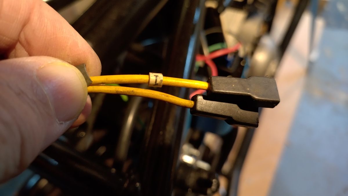

FYI; No idea of where it came from but the stator on my 250 2c also has a numbered yellow lead. (2 yellow, one green, one white wire).
20230107 IMG_0495.JPG (259.35 KiB) Viewed 11001 times

Oh wow that looks exactly like mine. Same font, same size, identical. And on there since the day it was made.
Are your green and white wires longer than the two yellows? Can you take a photo of the last section of wiring showing the terminals of the Green, White, Yellow, Yellow all in one photo to see if its like the one I have here please?

Yes.
Posts: 935
Re: Stator Question
Green and white wire should be longer because they go to the central electic port. The yellow ones have a shorter way to de regulator. I still can´t find a reason why one of the yellow ones is marked.
