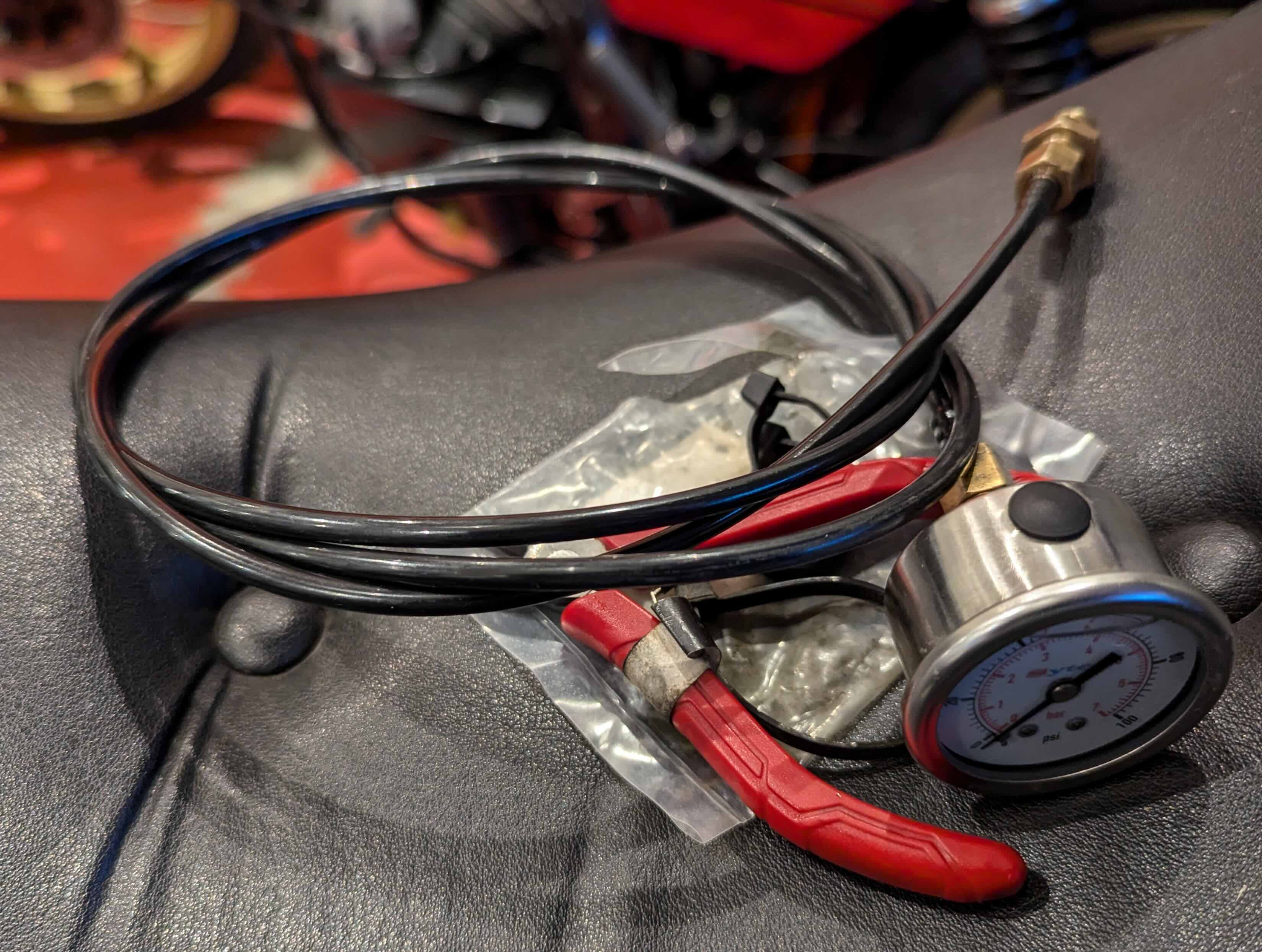

I've bought a 0 to 100 psi analogue oil pressure switch which has an 1/8 NPT thread (a very very fine thread) and an adapter (M12 x 1.5mm).
I ran the electric start with the kill switch on until I saw pressure readings, then started the bike as normal. The reading from cold at idle speed is around 58 psi. As the engine warmed and as I reved the engine in neutral the reading varied from roughly 50 to 70 psi. On the New York (and Excalibur presumably) the left footrest mount clashes with the oil pressure pipe, so I've got the footrest bracket unbolted and loose during these measurements. This means a road test isn't practical until/unless I adapt the footrest bracket somehow.

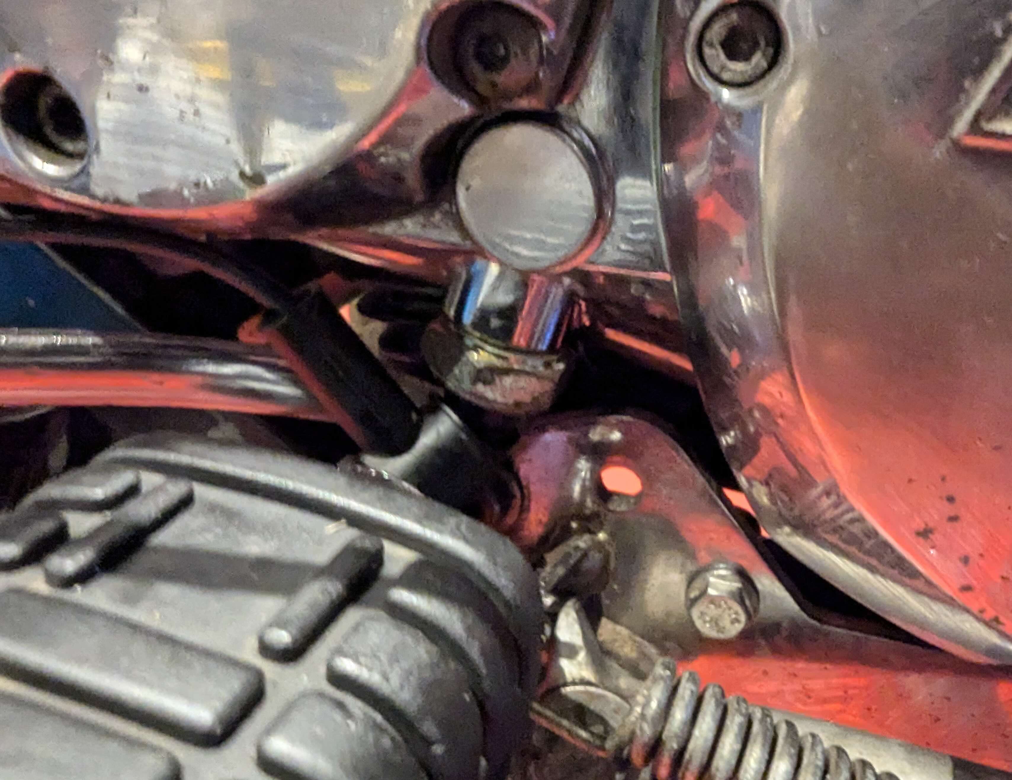

I promised some photos all those years ago, here they are after I'd removed the gauge. I found it hard to show in a photo how much the LH footrest impinges on the scope to fit the gauge; I have to remove the footrest to run the tube through the gap between the footrest's end and the bracket it fits in. I simply couldn't refit the footrest with the reinforced tube I'd bought to replace this thin black plastic one.
Oil Pressure switch area with footrest.jpg (479.17 KiB) Viewed 8890 times
Removed oil pressure gauge with pipe.jpg (487.97 KiB) Viewed 8890 times

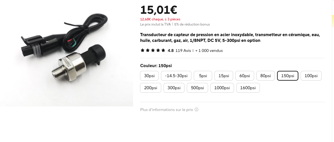

Is there room for an electronic sensor à la Druck, Burkert, etc? You’d need a suitable meter of course.
Edit: I was thinking of something like this, cheap enough for a punt, though the actual connector may be the tightest fit if you have limited room.
Screenshot 2024-09-02 at 08-54-41 Transducteur de capteur de pression en acier inoxydable transmetteur en céramique eau huile carburant gaz air 1_8NPT DC 5V 5-300psi en option - AliExpress.png
Screenshot 2024-09-02 at 08-54-41 Transducteur de capteur de pression en acier inoxydable transmetteur en céramique eau huile carburant gaz air 1_8NPT DC 5V 5-300psi en option - AliExpress.png (180.07 KiB) Viewed 8806 times

Ming wrote: 02 Sep 2024 05:05 Is there room for an electronic sensor à la Druck, Burkert, etc? You’d need a suitable meter of course.
Thank you, from the image I've found similar items in the UK (and China) The New York has so little space that it doesn't look like it'd fit even without the connector, however I'll have a ponder about what might work in the circumstances.
