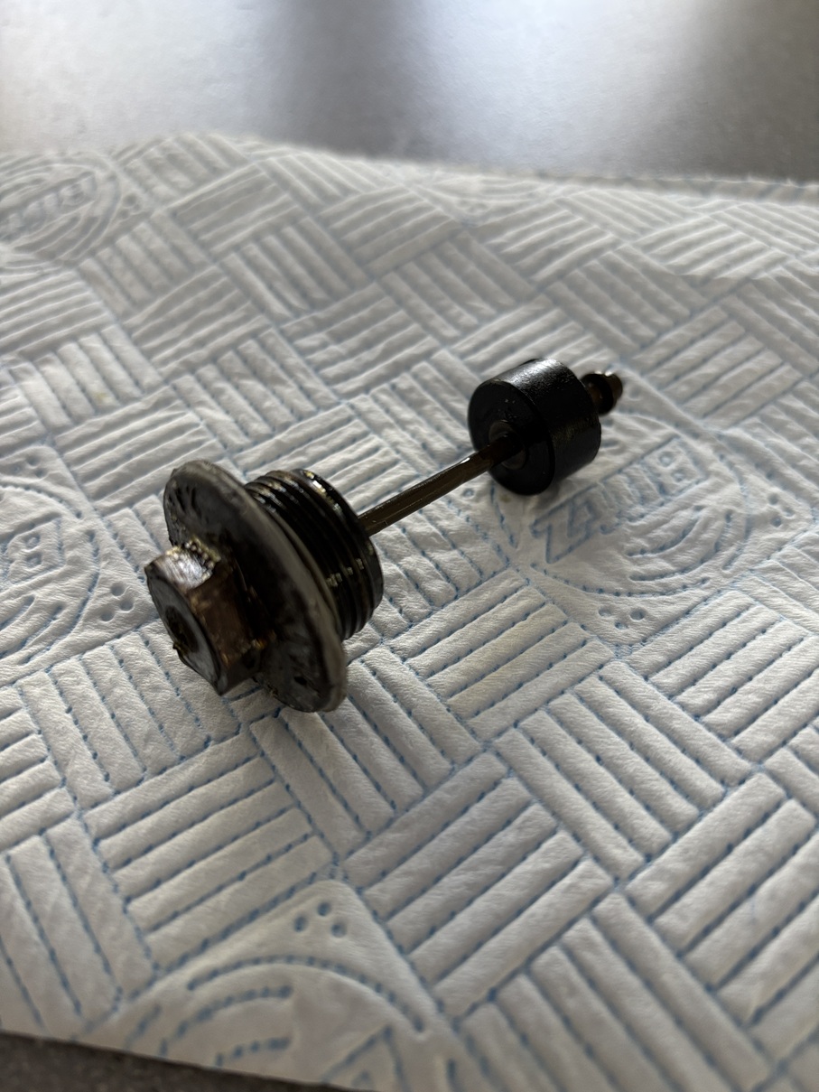

Hi, has anyone repaired one of these plugs successfully?
The one from New York’s wire is broken off flush so nothing outside to solder to.
As far as I can deduce the float has a magnetic core which suggests the presence of a reed relay in the wee tube. When the float moves down the reed relay flips and so lights the light. Tests show that it does work.
So is it as simple as unsoldering the top of the tube; extract the innards and solder a new wire on the bottom?
Any thoughts?

It is as you say, but it’s not easy to do. I would probably not try going in from the top, I’d probably try digging the epoxy out of the bottom and splicing on. Disturbing the brass tube and solder risks having oil leaks in the future too.

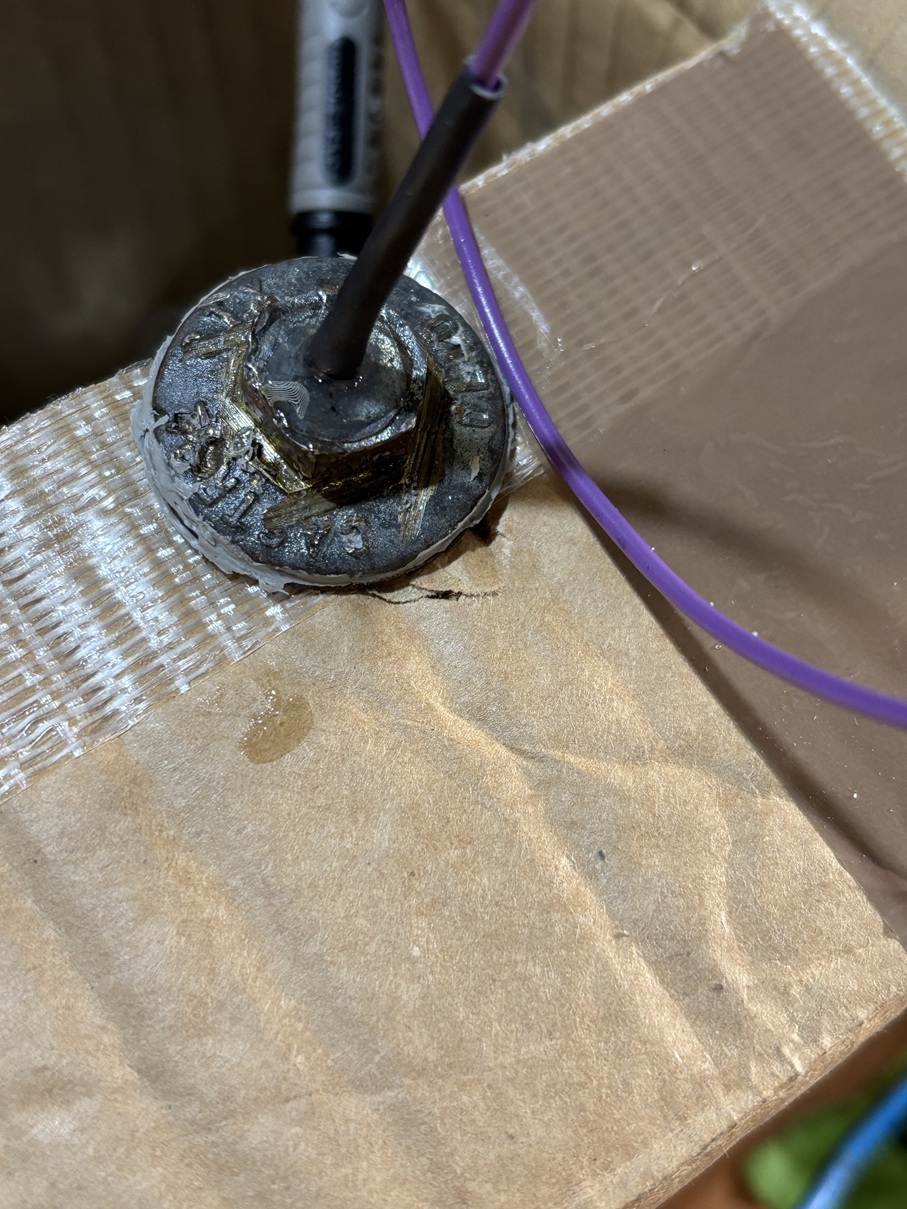

Re: New York/Dart Sump Plug with oil level sender
Thanks Julian,
I removed the epoxy and did manage to get a vey small bead of solder on the end of the stumpy wire and attach a bit of violet wire, the correct colour even. The float worked and switched correctly. I slid some heat shrink down to prevent the joint shorting to the brass plug and shrunk it up. Almost straight away the wire dropped off; there was not enough to make a robust mechanical joint.
Maybe I could reattach and fill with epoxy again which may mechanically support it

Would you happen to have any of the knackered oil level switch assemblies? If so, it might be instructive to dismantle one entirely and then work out how to replace each part and seal the shaft into the sump bolt. I'm hoping the long brass shaft, the reed switch, and perhaps even the float, would be available from suppliers. If so, the guts could be cut out and replaced with new parts and these then epoxied into a cleaned up sump plug.
If I have one, I don't know where it's ended up in my spares. If I find it I'm happy to dismantle it and will post updates here.
Hey there,
Repair is completed. Refixed withe solder and filled up the dish with araldite. Seems much stronger, I will give it a bit of support with a cable tie to the frame will see how it performs.
Thanks all for wise counsel.
